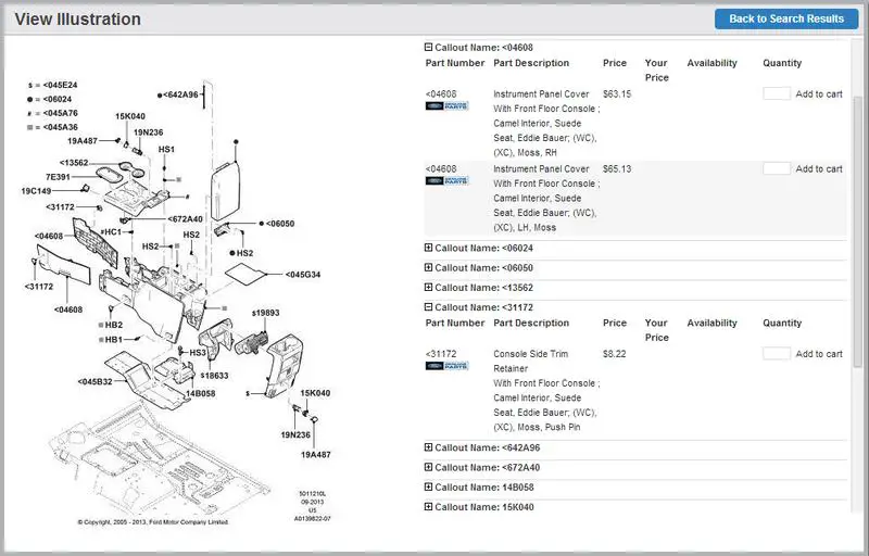

Okay, my 2006 XLT console has a 12V power point below the HVAC ducts between the seats for the 2nd row passengers to use. However the cap has broken off, leaving a always-ON open 12V socket available for curious fingers and such. Today I removed the center console rear cupholders, and the console lid and was able to access the 2 - 7mm bolts that hold the rear console panel in place. It pops off easily -- to a point. It seems that Ford's engineers left a curious length of slack electrical cord for this power point, say on the order of 2mm or so. Yea, SHORT!!!
In other words, I found no way to get my fingers underneath and disconnect the socket so I could pull out this rear panel to remove the power point and replace the socket cover to keep fingers and stuff out.
Anybody know of a better way? Do I have to remove the whole center console?
