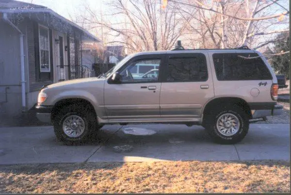

Here is mine with TT/Shackles and 31s...
