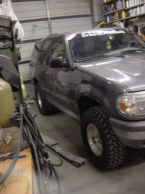

i'll let you know in the morning. wheels are at 4WP's gettin tires put on right now. i'll take pics of them with no trimming, and after trim if there is any.
i've got 33 x 9.50's on thier now with no trimming. i am anticipating a slight trim job with the 11.5's

for the nay-sayers.
32 x 11.50 15 pro-comp MT's (true sizes from PC website:31.4 tall, 10.9 buldge width, 9" tread width) on the stock wheels. 2" TT and a 2" add-a-leaf. no trimming. 100 miles since last night and no rubbing as of yet.
looks good sceep. It looks like you could clear 33's pretty easily too. A little trimming on the front bumper and take the plastic off the rockers.
33-9.50's fit just fine.. thats what i just took off of there. i doubt anything wider would work without some trimming.
