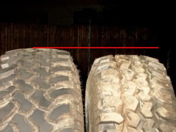

Actual tire diameters will vary from manufaturer to manufacturer (even model to model). Always check the actual specs of each tire you are considering! And ALWAYS take the "this size tire will fit" advice with a little bit of a grain of salt! They will always vary!!
Here is a pic I just took of two different manufactures versions of 35"s. These tires are sitting on level ground.
