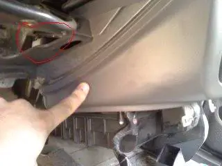

Here are a few pictures I took to help out you guys.
Here is the actual blend door actuator. Pretty tight fit between the AC/Heater unit and the dash.
The actuator itself is right behind where my finger is (sorry for the cheep graphics)
The red circle shows a small opening where you can get a socket with a 6-7 inch extension in to get the top screw in and out.

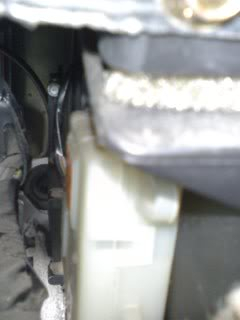

here is the view from the top, behind the stereo/vent/temp control plate. I hat to remove that to get to one of the top screws
good luck guys! Its a lot of work just trying to take things out and get them back into place.
