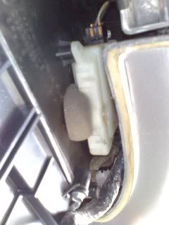

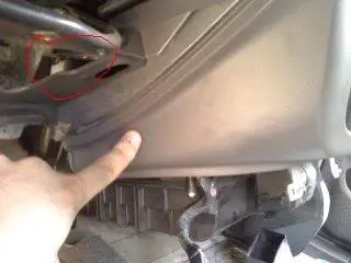

Did mine last night. Wasn't all that bad. Wish I woulda had a better selection of tools available to me (they're pretty much all in storage right now) but I got it done with nothing but a 1/4" drive ratchet 18" worth of extentions and some sockets. And a little skin.
here's the reason for all that. Ridiculous.

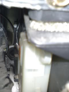

You can see one of the teeth laying inside the case right under my thumbnail too.
