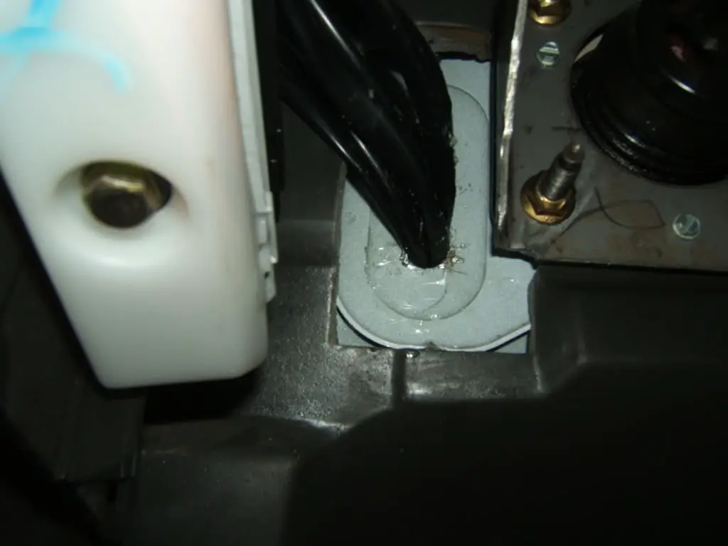

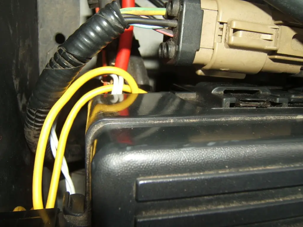

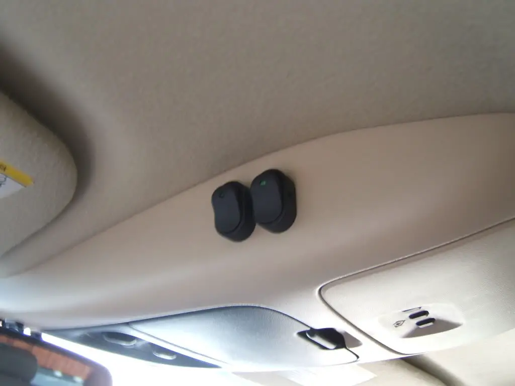

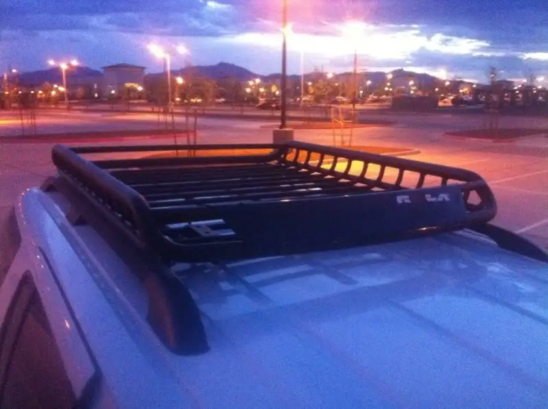

Very nice ride wanacustomx! Jwigs7, i was planning to do a write-up with pictures and everything, but of course, my camera died the day of the install. how we did it was we made all the wires go thourgh the inside of the crossbar and come out of the bottom on left side. then they went into the front of the rack where it connects to the roof. We took the rack off and drilled a hole through the roof and routed the wires through that, into the headliner, where the ones that went into the switches went into the overhead console, and the others ran down the A-pillar and the under dash through the firewall, through 2 holes we drilled there to get into the engine bay, from there we just wired them up to the fuse box and mounted the relays inside. got it all together again and it worked!
