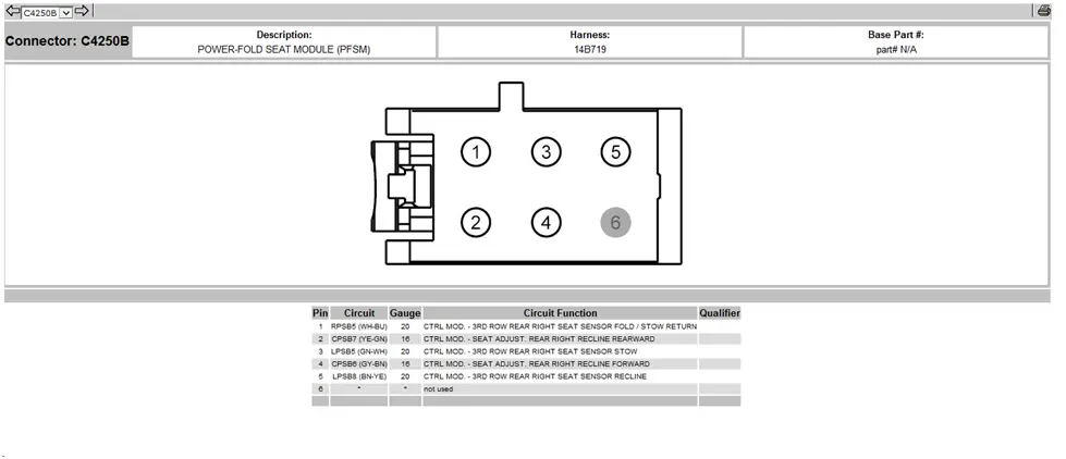

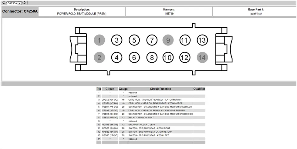

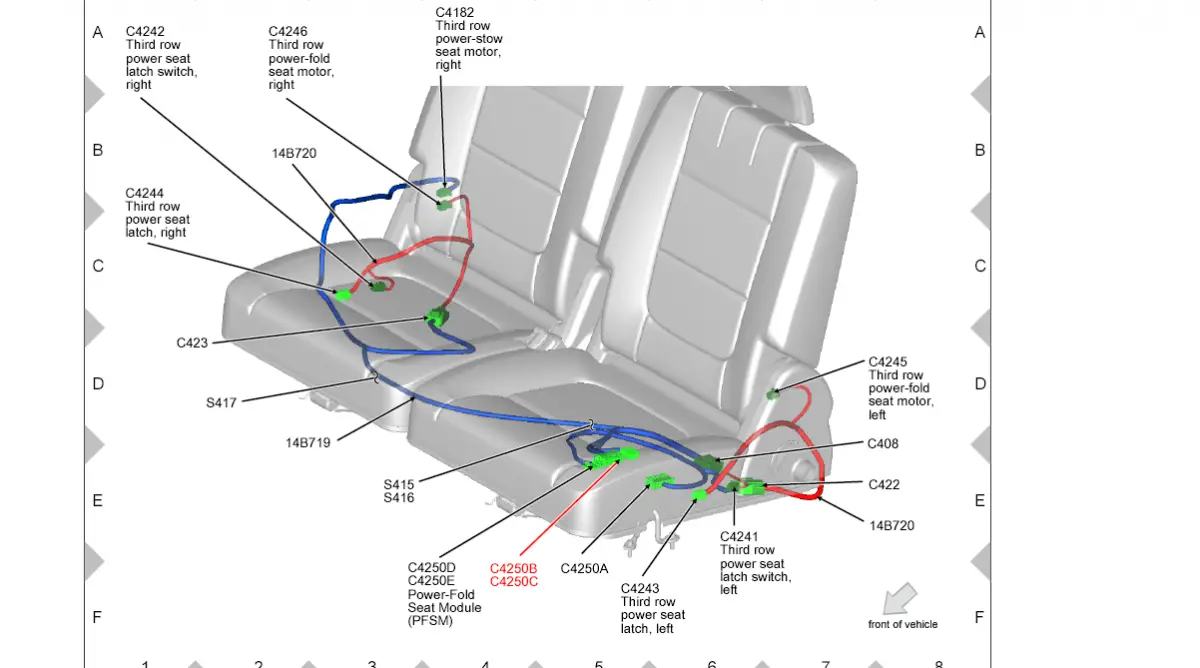

Here is info from the factory wire harness manual:
