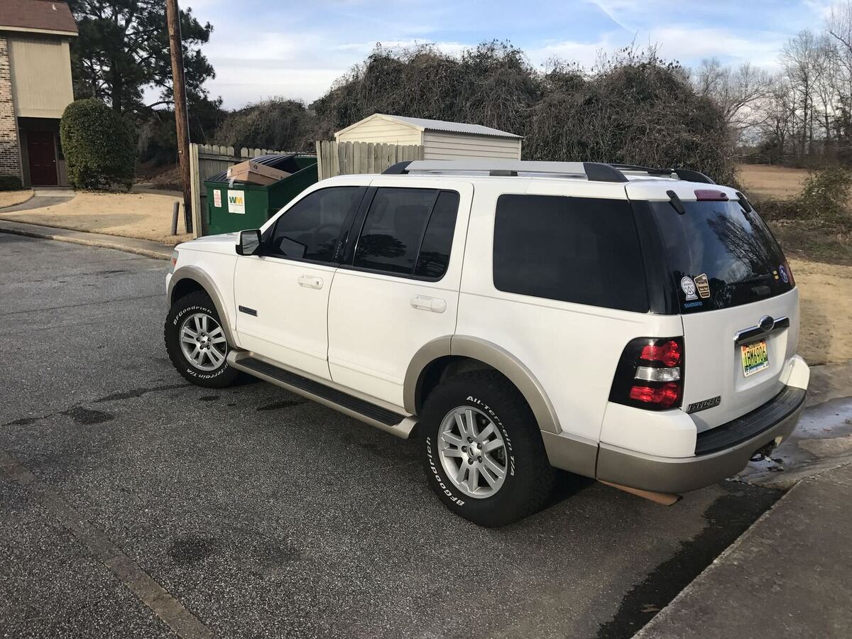

Pics for fun

Your truck looks mint, nice color combo, but you would need to change the front and rear diffs to 3.73 add tranny cooler, and install/upgrade the hitch to class III/IV to be comfortable.

As above you ride looks mint. I wouldn't risk it.

First off I want to comment that your images show you have a very nice Explorer. The wife and I just bought our first Explorer, a 2007 xlt, last week and we love it. It's also a V6 / 5speed auto with 4WD. Ours also has the small 1¼ inch Class I hitch. Since it sounds like you are only going to be towing a couple of times a year, you might consider getting a 2nd more heavy duty vehicle for that. It need not be new or costly. Because a lot of the heavy duty trucks and suburbans from the 90's are considered relics and gas hogs you can find some good deals on them. You won't be using it a lot so your annual fuel costs won't be much different than it is now, and you won't need to be modifying your nice Explorer or putting excess wear on it. We have a 95' diesel suburban 4x4 with a class III hitch that will tow just about anything. We had considered trading it in on a new or late model Explorer, or selling it outright and buying a newer Explorer, but realized that we couldn't get much for it by trading it in or selling either one so we decided to keep it. We wound up buying an older model Explorer, but for a lot less expense than we were going to spend on a new one. We'll use the Suburban for all of our towing / hauling and other dirty work and keep our new-to-us Explorer shiny and nice for the road. I am somewhat unconvinced that our Explorers ( at-least 06 - 10 models ) should be used for any kind of towing anyway, or for that matter off-roading either. Then I think that frequent towing with our V6-5speeds may drastically shorten the life of our 5R55 transmissions and cause many of the transmission problems that I read about here. It's just my opinion, but I plan to do good maintenance on my Explorer transmission, never tow with it, never use it as an off-road vehicle, and I am hoping it will give me in return many years and 2 or 3 hundred thousand trouble free miles. IMO Your Explorer is too nice to be modifying, get an old beater to do your heavy lifting.
