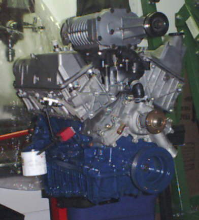

Here is what you need?
Whoa! SH@T! That's the supercharger on top of that SOHC 4.0 .... are they testing it or what?
I will be sporting one of Explorer Expresses Super Chargers on my Explorer Very soon. I can't wait to feel that power! Grrrr
The above pictured 4.0 supercharger set-up on a stock SOHC in a 01' ranger put out 247 RWHP and 290 FT/lbs of Torque. This was a stock engine, stock MAF, stock computer and stock air box.
