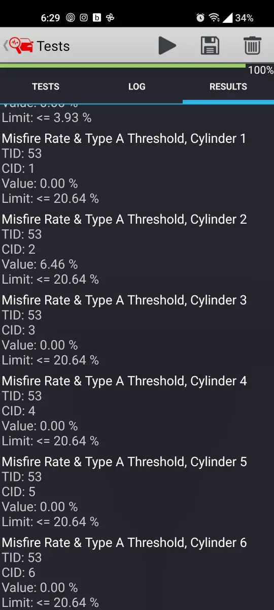

So I've developed a misfire in cylinder 2 according to mode 6 test in Forscan and many misfires counted on each drive cycle 300+. Weird thing is when running the mode 6 test it says cant verify something about egr duty cycle and something about catalyst but egr pid shows cycling and downstream o2s are fine. Only while normal driving at about 35-50 will it miss and feels like something tugging at it. If I give it about 30-40% throttle feels fine and flooring it feels fine.

So ended up taking it to a mechanic. Not sure what they were looking at or what scanner they have but they changed the spark plugs and said it was running good but blamed on maybe a transmission. Using the number of misfires pid in for scan proves otherwise.
So before driving home today decided to disconnect and cap off the vacuum hose to the EGR valve. This made a huge difference. I went from 300+ misfires to 91. I did notice some spikes on the highway while decelerating but like pressure on the throttle. So I think they may be some inaccuracies in the reading and the stuttering was almost non existent, I probably felt it only about a handful of times.
