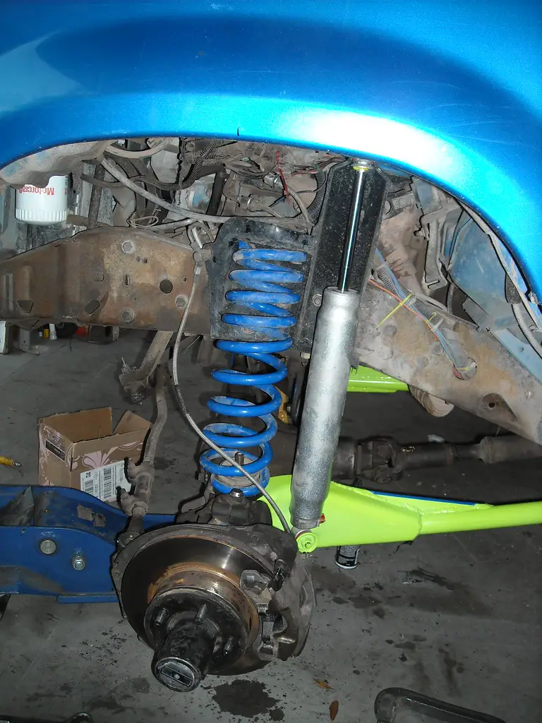

Here is our Explorer spring bucket with the f-250 shock mount (with shock installed)
Both ends of the shock are "eye" type mounts.
EDIT: I found a picture of the mounts when we got them. You can see how they are just welded on/next to the coil bucket.
~Mark
Thanks Mark. I guess since i was looking at the 250 with it's own spring bucket it looked like ours. Thanks, you cleared that one up.

I found the type of bolt on’s you are looking for were only on the Heavy Duty F250s that I came across in the Bone Yard.
The rectangle style that Maniak has welded to a cut up explorer bucket are part number E5TZ 18183A through the dealer.
I got mine off a 1997. I found a 2003 that had a similar set up but the plate area that bolts to the frame was a diamond shape.

As to the shock mount question. I think I must have been looking at a newer 250 and that is why I was confused. the 97 spring mount looked nothing like the one I got today.
