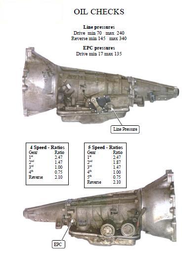

Welcome to this forum! Check the main pressure, and the EPC pressure with a 0 - 300 PSI test gauge. There are many possibilities such as a blown valve body gasket, loose valve body bolts, failed EPC solenoid, no power to the EPC solenoid or blown seals within the transmission.

The main test pressure port is on the driver's side of the transmission, and the EPC test pressure port is on the passenger's side of the transmission. Another thing to check is the range sensor which is located on the driver's side of the transmission. A defective or out of adjustment sensor won't tell the computer which gear you're in. Check this diagram for more information:
