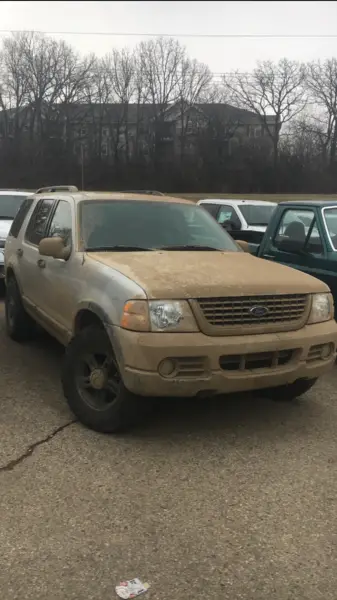

i have a 2003 XLT v8 Explorer and am wondering how hard a 4r70 swap will be. It will be on a 3” inch lift in the front and 2” in the rear and 1-2 inch body lift. (or more if needed) any ideas or suggestions would be very helpful and appreciated. Already blew up stock one and had to have the new one rebuilt again. Has had a newish differential put in has about 90k on it And torque converter is now on it’s way out the door I think. Have plans on possibly building motor and slapping a supercharger on.
