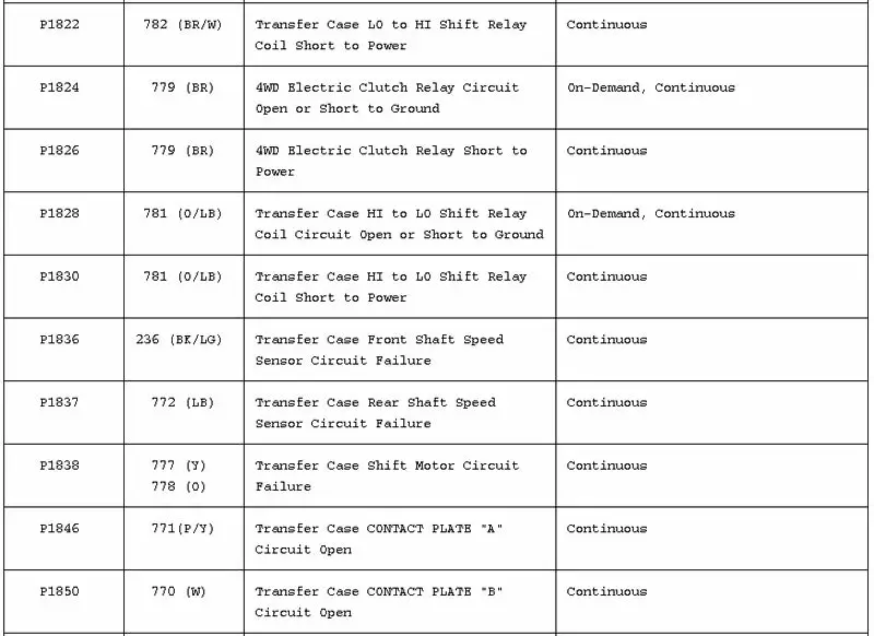

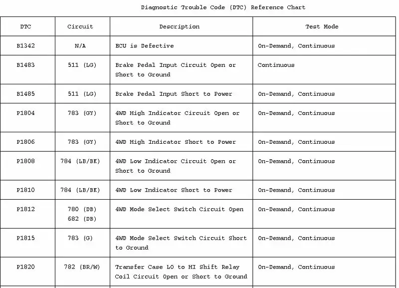

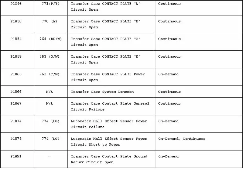

I haven't ever seen anything (either in the Service Manual or on the forum) that relates the flashing of the 4wd lights to any particular issue (e.g. five blinks = bad shift motor) The owner's manual just says there is a problem with the 4wd system. The service manual says that a DTC has been stored in the GEM. My 97 manual has a chart of the DTCs related to the Transfer Case:
