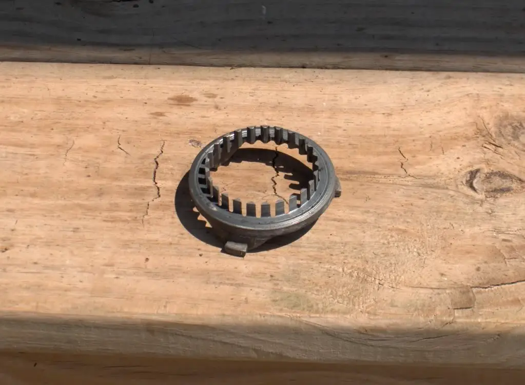

Alright, I modified a set of needle nose pliers, got the ring off and this is what I found in the drivers side hub.....

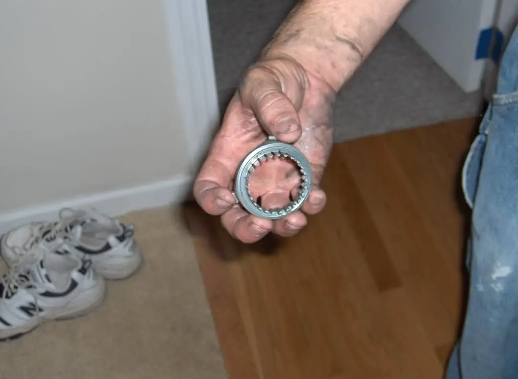

I'm guessing this isn't supposed to look like this since the passenger side one didn't. Does anybody have a part # for this?
Never mind. Went to the junk yard a little while ago, got the part for $5 put it in and presto my 4X4 working again.
