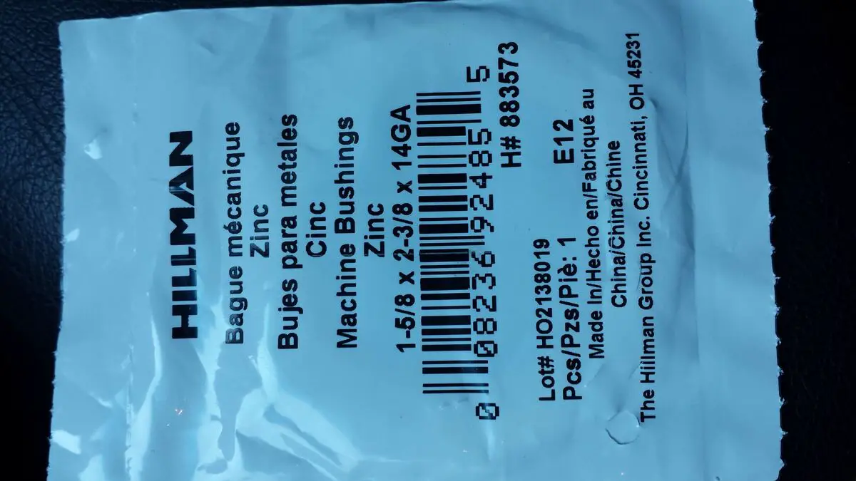

I am well aware that this thread is many years old, but I came across this thread yesterday, and today set out to find washers locally instead of going to a diesel repair shop, and I did.
I just wanted to share my findings with this forum to make it a little easier to complete this project.
This DIY saved me $200, all for $5.39 in washers at Lowes.
They were in the specialty washers drawer, its purple colored.
P/N: 883573
Below is the image of the washer I bought.
I bought 4 of these and used 2 for each one.
The outside had to be ground down which didn't take long, I stacked all 4 in a vice and ground them all down together.
The inside fits perfectly.
4wd works excellent now.
Good to know, csibbs. My fix is nearly 10 years old and still works perfectly.
