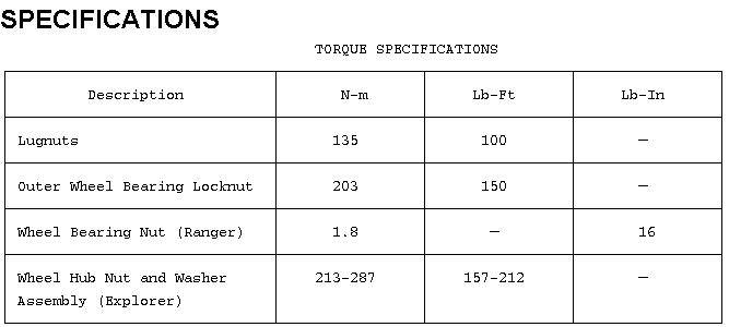

Thanks Brooklyn. Thats what I needed. One problem is, the drawing is not showing the axel that drives the hub assembly. I need to know what the torque is on the axel bolt?

Holy Cow. That's tight. Thanks again BrooklynBay. Looks like an easy job. I'll report back upon completion.
