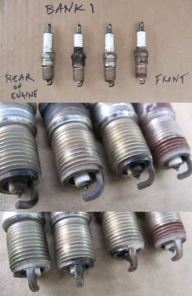

After checking the spark plugs (bank 1 plugs pictured below)... they look ok, I warmed her up at idle then headed out to the auto parts store. Before I got 2 miles got bogged down with flashing warning light 'cause cylinders were missing all over the place. Lean, you betcha! Hobbled home and waited for wife to return with her (extremely reliable) Nissan Sentra. Code reader showed fuel trims working overtime to correct things... and not doing it.

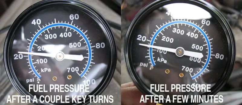

So, today got the pressure gauge and sure enough 410 knows what he's talking about. 0 pressure when hooked up, rises to 28 with 5 key turns (held about 3 or 4 seconds each), and starts drifting down within a few minutes. (Why drifting down, since there's no return rail?)
Moral of the story: Too much air can really mean not enough fuel. And don't buy cheapo fuel pumps (unless you enjoy installing them often.)
