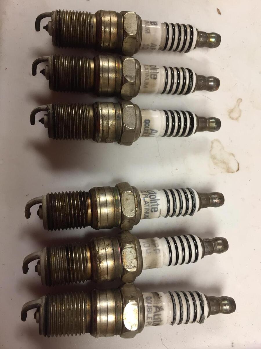

I remove the spark plugs from my daughter's 2000 Monty 5.0 today. They were Autolite double platinum's and had around 80k on them. They were almost new when I bought the truck back in 2012, and I had checked and re-gapped the plugs to .54 thousands at that time. Since then my daughter has driven around 70,000 miles.
The truck still had it's original OE plug wires, which I replaced yesterday, and the truck had been running like a Swiss watch until a few weeks ago, when it developed a noticeable miss. I expect the new spark plugs to arrive from RA tomorrow, or maybe Tues.
Here's what has me puzzled. The CEL had reported a misfire on cyl 6 and had earlier reported multiple misfires w/out the CEL having come on. I decided to pull the plug from cyl 6 first. Holy crap! The gap was about .80 thousands. Then I pulled plugs 5, 7 and 8. They were all .80 thousands. I'm pretty sure this has a lot to do with the misfires. Then I pulled plugs 1-4 and they were really in good shape, measuring maybe .55-.56 thousands.
Does the 5.0L use a waste spark on bank 2? Is that why all the plugs on bank 2 were so worn while bank 1 plugs were not? I don't recall seeing this on my 2001 Expl 5.0L when I changed its plugs.
