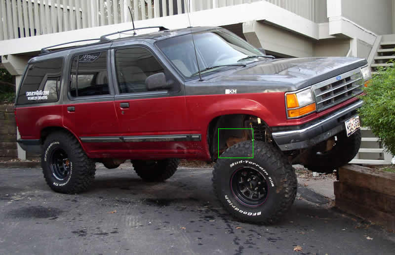

pm means private message, and here's a pic of mine with 5.5" and 33x12.50's. it's flexin a little, but you get the picture.

did u have to do any trimming
Yup, if you look where the box is, you can see where I just had to cut a little bit of the fenderwell out. I also ended up having to cut off these tab like things from both sides because they ended up rubbing. Anytime that I'm wheeling fairly hard and the tire is pushed back at all, it still rubs right next to the lower left hand corner of the green box in the picture on both sides, so I need to take a sawzall to it but haven't had the time. If you were to go with anything bigger than 33x12.50's or anything more than a 15x8 rim (15x10 for example) you would rub the hell out of your fenders with just the 5.5" lift.

your rims are 15x8 right?
yup
