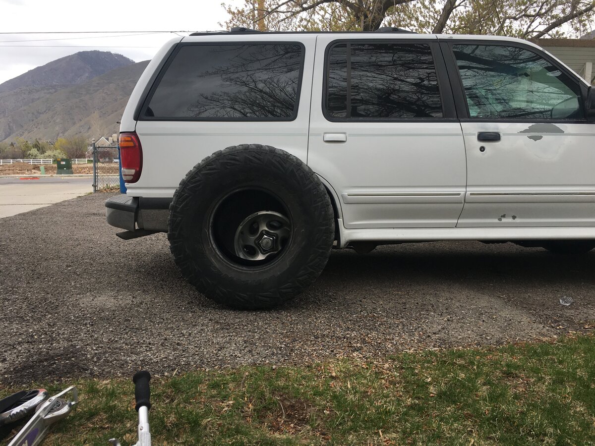

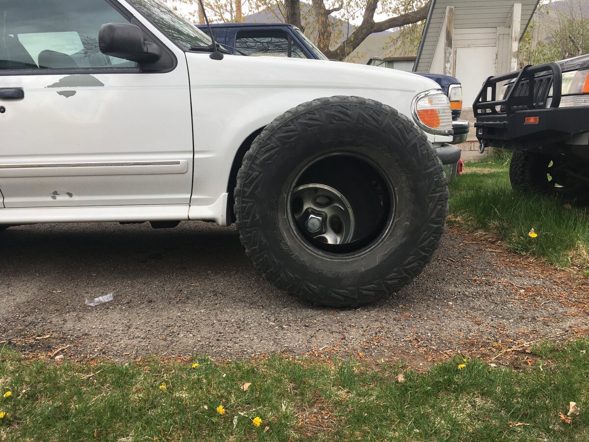

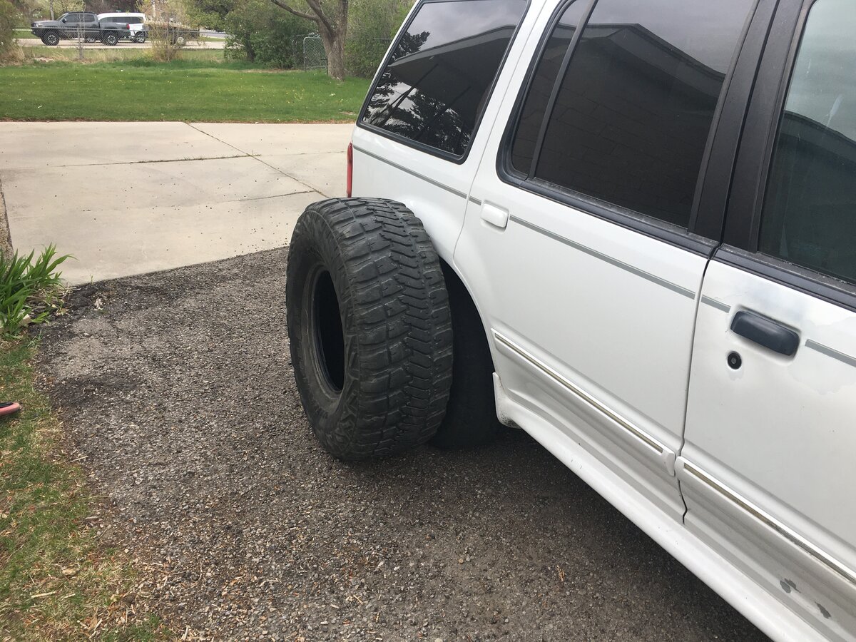

Oh yeah, I also picked up a set of used 38/14.50/17 MTR's for really cheap,which pushed me in this direction. Cheap impulse buys always end up costing me a lot more money...
