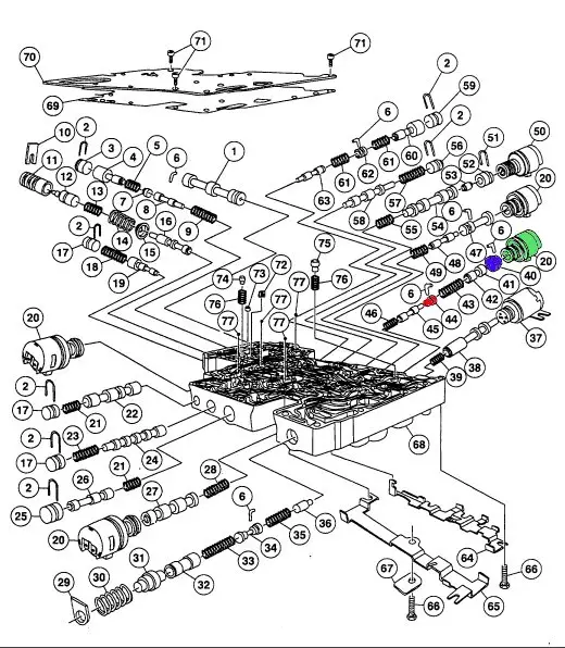

Hey all,
Ive been fighting a 2-3 flare and swapped valve bodies with a used one I got from a local trans shop to see if the vb itself would make any difference. Well, the 2-3 shift flare is gone it seems (at least so far) but a new problem arose.
I never really test drove the truck on the freeway before so i'm not sure if this is a new problem or not, but once up to highway speeds the trans doesn't seem to shift into overdrive.
I got those two codes which are incorrect gear 2 and incorrect gear 5. This is what I've done:
Trans rebuild kit
New TC
New EPC
Superior shift kit
New Bands
Bonded plate gasket
Ford Blow off kit
That's all I can remember for now. I've given it everything that has fixed the flare for others, but now I've got these codes. The shift solenoids ohmed better on the used vb than on my stock one, but my guesses at this point are either a shift solenoid or the servos on the side of the case. Either way....anyone else have any experience with these two codes coming up together? Thanks.
