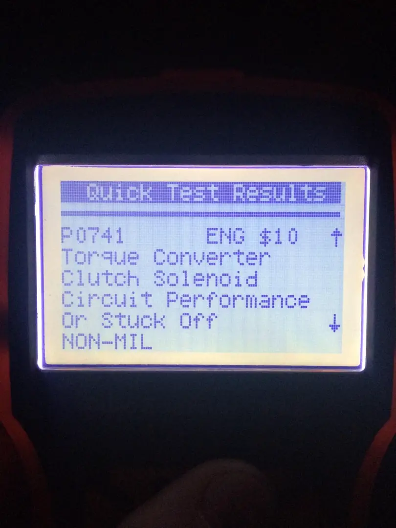

Ok so I didn't quite remember the code correctly. I just went out and pulled codes again and took a picture of what came up (P0741). Looks like it might just be a solenoid issue.
Its rarely the solenoid, it most likely will be the converter. Thats what I see at the shop. That shouldn't stop you from trying the solenoid first it still could be, just saying.

What all is involved with swapping the TC? It's right at the bell housing right? I'm thinking if I disconnect everything and slide the trans back I can get to it without having to cut my crossmember out. When I redesigned it after the SAS I welded it to my frame. Dumb idea but who knew a new transmission would crap out in 40k?
You will have to remove the tranny, you will also need to make sure the converter is fully seated into the pump before bolting it back to the engine. While it is out make sure to check the sealing ring on the end of the pump stator, if it is damaged it can cause lock up problems.
Converter failure like this can happen at any time, the transmission is probably ok. I built one of these a few weeks ago and the converter lost lock up a week later, swapped the converter out and all is well. Nothing you can do about it. I know thats got to be tough that the cross member is welded in.

I cant remember the last time I needed a TCC solenoid for the 5R55E, but they do fail, so I think the OP should try that first in his case, pulling the tranny can be a pain especially with a welded crossmember:eek:
Turns out it was the TCC solenoid. I replaced it this morning and the truck has been shifting normally since. Thanks to everyone who chimed in for the advise.
