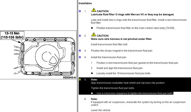

Need to drop the trans pan to change the filter. NE1 have the torque specs for the trans pan bolts?
The spec for torquing the A4LD pan bolts is 96 to 120 in lb. Is it the same for the 5R55E trans?
Thanks in advance.
Bill M.
Fluid pan to case: 8-10 Lb Ft, 11-13 Nm for a 4R55E. Yours might be the same. Hope that helps.
This is from the 97 service manual for the 5R55E:
Riverrat - Appears that the A4LD & 4R55E have the same torque specs. Usefull information.
dogfriend- Exactly what I needed.
