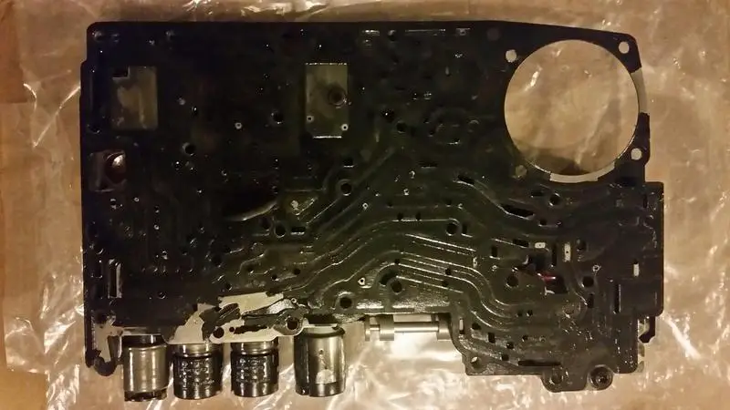

I started to get the 2-3 flare and reverse never clunked, but always felt like it was slipping a bit. O/D light started to blink and when I turned the motor off, back on it would work OK for a bit then flare within a mile. I immediately parked the truck.
I rolled the dice and bought a rebuilt valve body ($240) off of eBay from Shift Rite Transmissions, it has the Transgo Shift Kit in it.
Swapped out the old valve body, filled it up with Merc V and it has been driving like a dream - have 300 miles on it so far without a hiccup.
Attached is a picture of the old valve body, the separator gasket blew-out at multiple places (silver area around servo and round reverse valve) - this explained my problems. I figured I would buy a rebuild instead of piecing the parts together, and the rebuild has a warranty.
I think by not driving my truck when this started saved my bands and other internal damage.

I was in the same boat (minus the reverse clunking). I would pull the valve body off and look at the separating gasket (right on top as you drop the VB) - this will tell you REAL quick if you are having fluid blowing by causing the 2-3 slip - maybe even with the reverse issue, but I am not sure.
I would pull the VB and access from there... I went with a rebuilt because I did not want to piss around ensuring the servo's were OK or not. They did check out fine with an OHM meter, but you never know if you have other issues lurking. If anything in the VB fails it is on Shift Rite.
Okay I appreciate it, I think that's where I'll start and go from there. I just don't think the whole tranny needs a rebuild that's gonna cost more than it's worth. So shift rite has the valve body that's rebuilt with shift kit in it and it has the attached gaskets?
Most certainly does (completely assembled) - I searched and found the VB on eBay. The VB was a complete plug-and-play. Arrived quick and packaged very nice.
