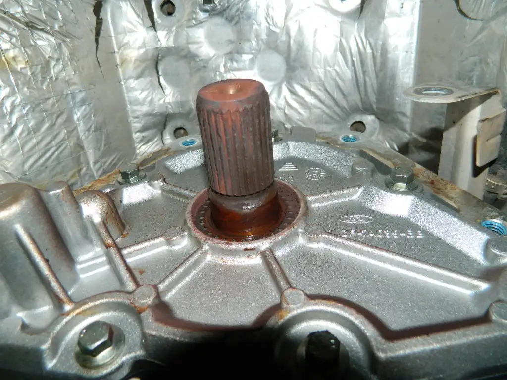

Actually determined the issue to be the transfer case, as it decided to grenade the other night. I will post my findings once I tear into it.
Huh, weird. I am guessing you have one with the full-time AWD?
Yup, its coming out tonight, hopefully disassembly at work tomorrow with pictures to follow.
Well, not what i expected. the trans output shaft and transfer case input shafts are stripped. a ton of rust powder came out when removed. First I have heard of this issue.
Wow, that is wild. At least you caught it before something catastrophic happened!
