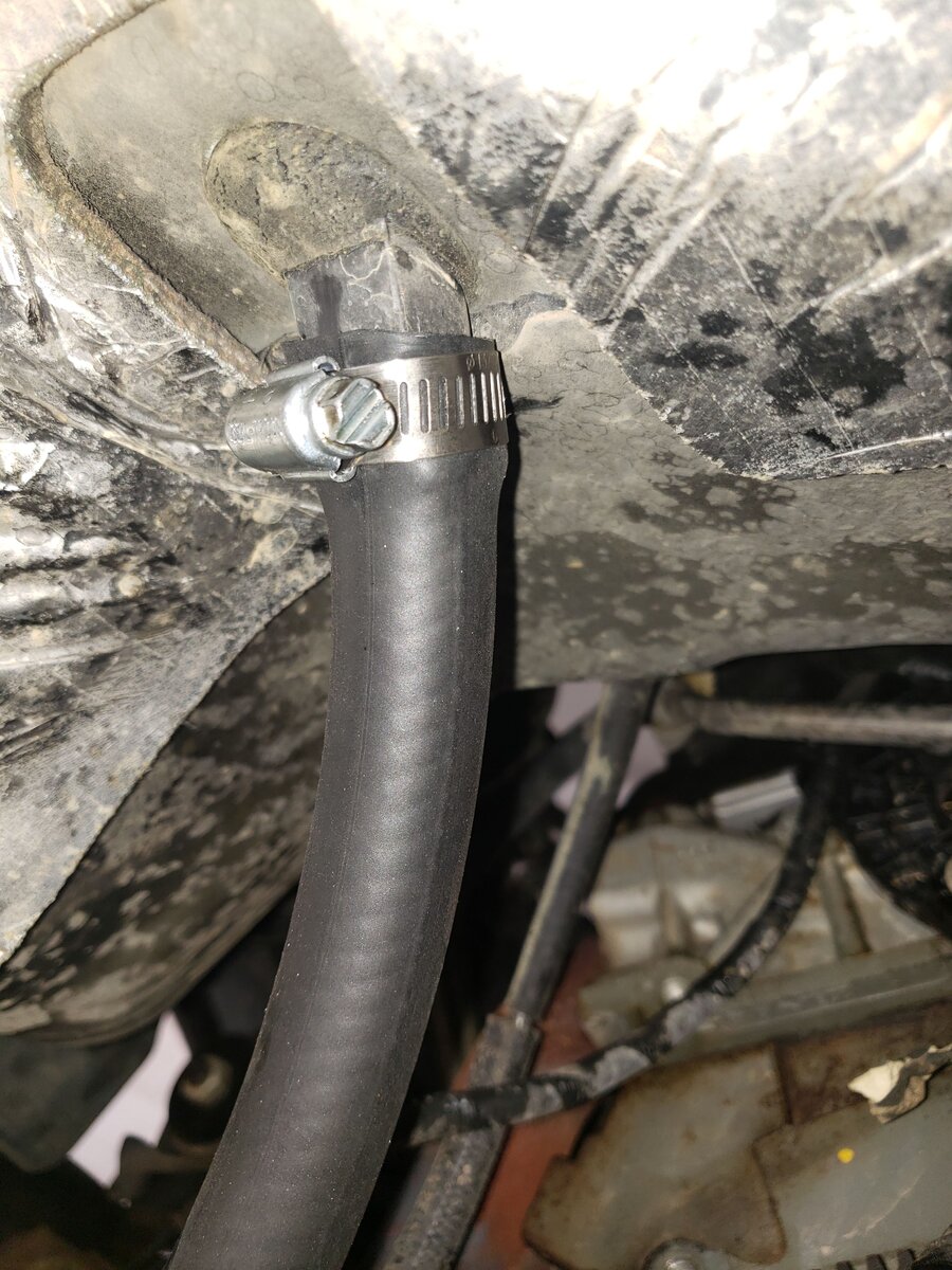

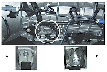

Was there a update plate or something that covers the connector so water from the ac won't get in the plug?
TSB 09-22-15. 2006-2010

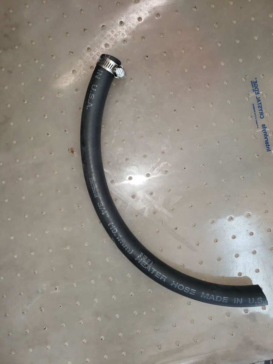

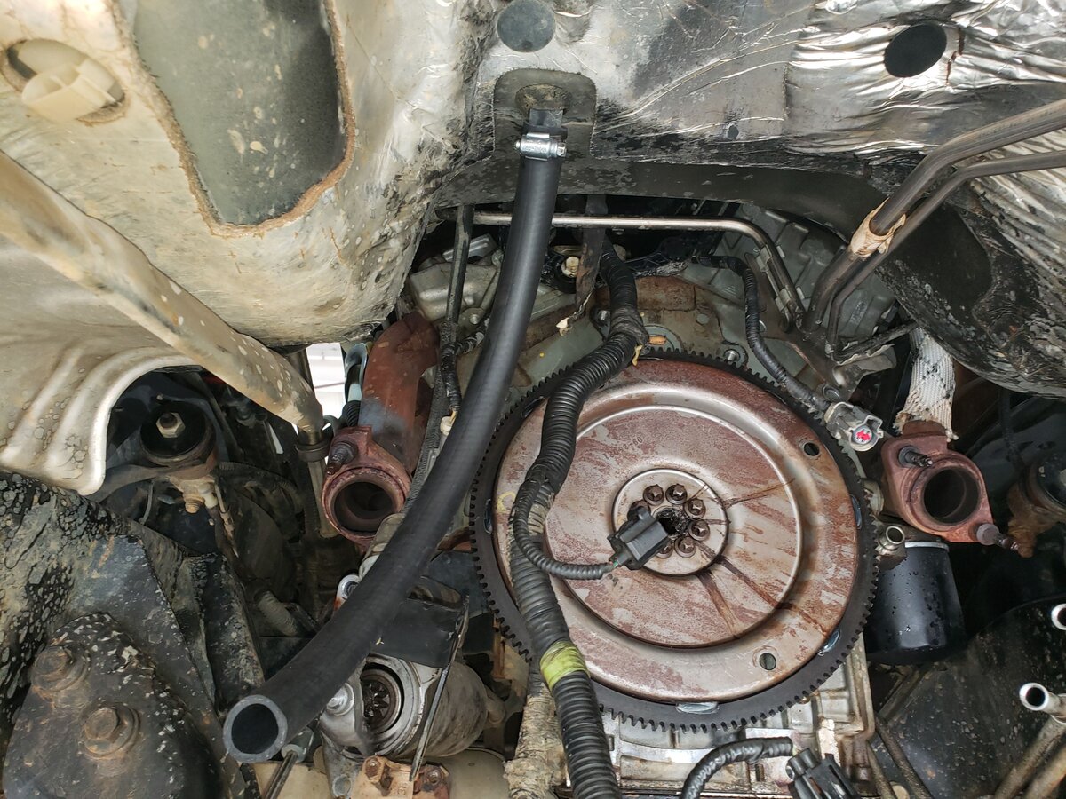

We add a piece of heater hose to the drain and route it past the transmission connector.
