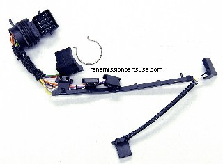

Check trans oil temperature with diagnostic tool,It may be very low or to hign. Cause it the temp thermistor on the plastic u ring that supplies voltage to the solenoids. ford has the plastic ring with termistor buildt in. Carfully unclip old ring from trans solenoids. LOOK at new part to insure all solenoid push pin connectors are open enough to allow solenoid pins to enter.lots of luck, quick fix. thermister also being used as a pull up resistor for o/d Crkt.
