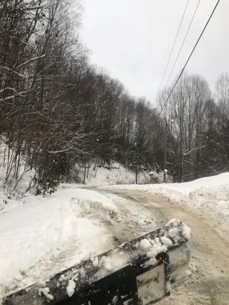

It looks like your getting a good snow storm today. It looks wet and heavy too! Hopefully you can try out the hill decent and report back to use.

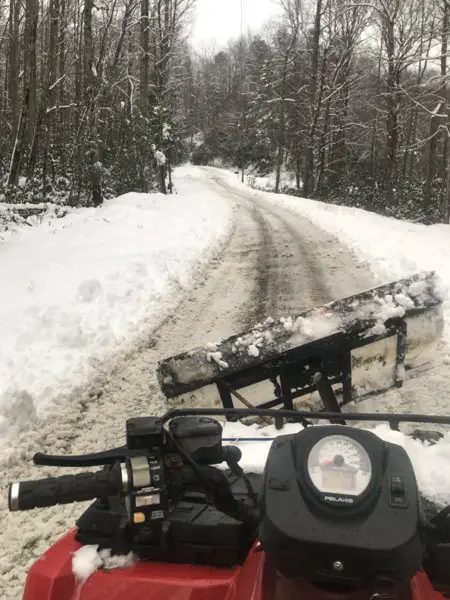

Thats a strange looking plow on that Polaris.
We ended up getting 12” +\-. Hoping to try out the hill descent tomorrow! The plow is a diy setup that I built from scrap steel and a plastic 55 gal barrel...lol! The irony is, I had a friends 45 horsepower Massey with a loader here for some repairs all the way up til Saturday evening...about 2 hrs before this snow came...lol! The Polaris and diy rig works good...just takes a little longer.

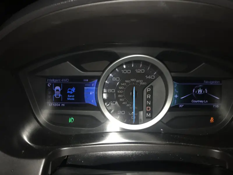

I did notice this symbol in the far lower right corner when in mud or sand mode. I believe this is “traction control off”. Not sure what exactly that means but I’d did still have torque distribution to all wheels as needed according to the message center on the left. I will say that mud/sand modes delivered torque to the rear wheels much quicker that snow/normal modes when accelerating.
