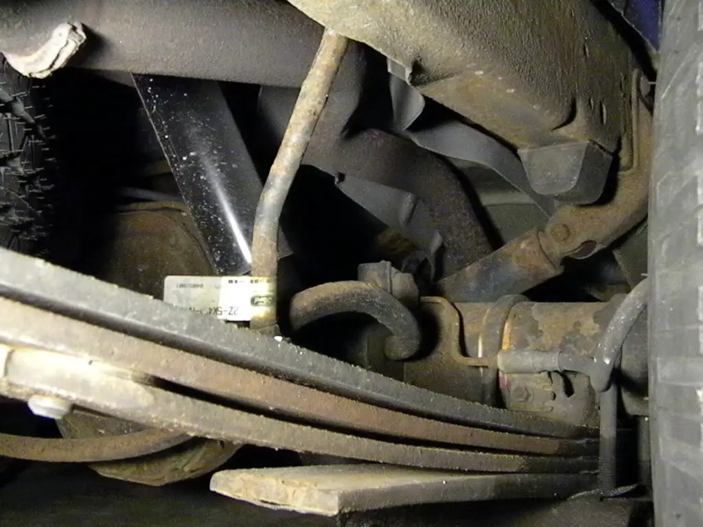

Better picture of 5th shock located on the back right
you can see the main shock (glossy black) and the 5th which is the one running more horizontally

@fordfrystak... by the looks of your picture, it looks like your shock should probably be replaced, and probably the same on most of our trucks.
I've read in some other threads that people remove them completely, but in general it all depends on the individual explorer. My vote is keep it and replace it... i love having and old (paid for) ride that feels like new. ive done quite a few repairs now since feb 2011 when i bought the vehicle and every repair is making the vehicle marginally better each time.

it's actually a vibration damper, it keeps the rear from oscillating when moving up and down

I took mine off only because I put air shocks on the back of my explorer and it would not let me blow them up with out binding.
so I ditched it!
never had a porblem with out it.
