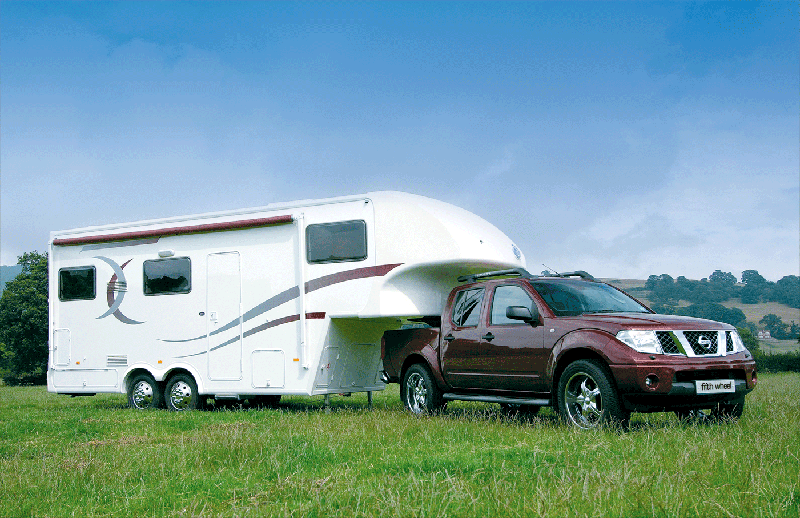

..You should be able to get a fifth wheel set up with your ST...;)
..If they could do it with a Nissan you can do it to a Sport Trac..
..and a Ranger..(Mazda)..:D
..Sorry...I could only find small pictures of Sport Tracs with fifth wheels..:dunno:
