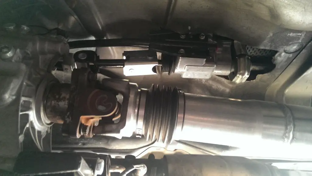

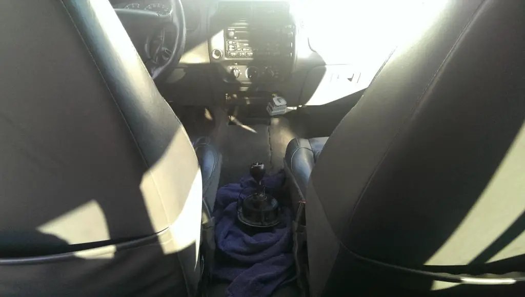

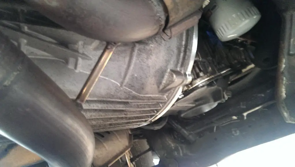

I have a 2001 Explorer XLT 4.0 SOHC with a Getrag MT-82 6-speed manual transmission from a 2011 Mustang GT. It was a great learning project for me, and luckily I had my dad's mechanical expertise to guide me. It took about a month and required a good amount of modification. It's mostly complete, everything works but there are a few things missing (such as reverse lights, custom shifter, and a shift boot). I have been driving it for over half a year now and it's loads of fun. Gear ratios are: 3.66 - 2.43 - 1.69 - 1.32 - 1.00 - 0.65. For comparison, 5r55e auto was 2.47 - 1.86 - 1.47 - 1.00 - 0.75.

Here's a parts/mods list:
-Stock Explorer clutch pedal and master cylinder assembly with custom steel braided clutch line.
-Stock 4.0 SOHC flywheel, clutch, pressure plate.
-Throwout bearing, slave cylinder are stock Mustang and came with the MT82.
-Stock Explorer manual transmission starter.
-Bellhousing adapter plate, Custom pilot bearing and sleeve from a kit: http://themustangsource.com/forums/f670/05-08-4-0-v6-tremec-tr3650-tr6060-adapter-473553/
-Custom transmission mount/crossmember (a piece of unistrut worked temporarily but I wouldn't recommend)
-Custom 1 5/8" shorty headers with custom 2 1/4" Y-pipe to fit around transmission (stock cats).
-Driveshaft came from a junkyard; stock 2006 Explorer/Mountaineer with 4.6 V8 and 6-speed auto (must be a 2006-2011 and must have the 4.6 3V V8). It has the correct flanges on both ends, lightweight aluminum, and has a slip joint. Can be used stock length but not recommended, I had mine shortened approximately 1 inch.
I'll try to post some pictures soon.
