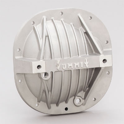

I think I will be going with a Summit branded one. It comes complete with all the hardware and gasket. Plus I like the ribs better than the plan look of the svo one. In fact the only thing I like about the SVO one is the SVO. So I plan on getting the Summit part and milling off the Summit word in the back and milling in STREET.

Summit Cover, complete kit 139.95:

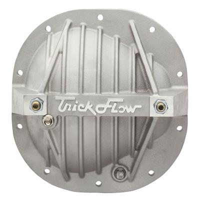

TrickFlow cover, complete kit 139.95
The only difference I can find in the Summit and TrickFlow kits is that the Summit kit comes with a Magnetic drain plug and the location of the fill plug.

I think I like the summit the best, but how are you going to keep that 'just new' look? Will you seal it with anything?

I like the summit one the best. I already had my eyes on one for mine.
