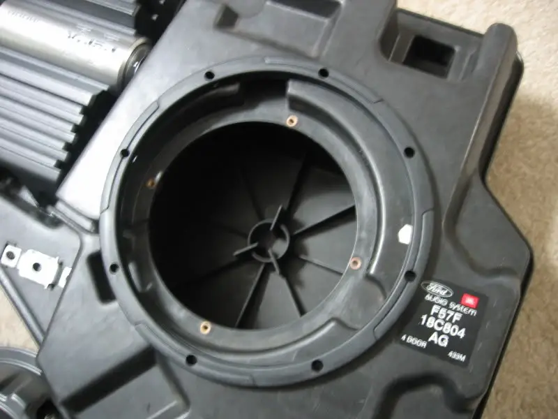

Im using the same box as you, what did you use to fill in the gaps from the "pocket" things in the plastic. When my sub is mounted those holes are still showing a little bit making the box unsealed.

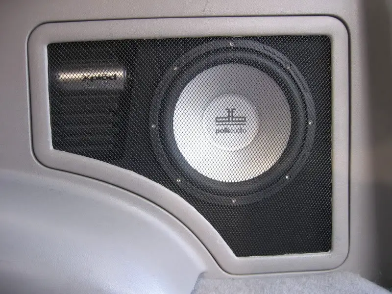

i had to cut a LOT of material from the factory box on my install.. there were sections that needed filling so i used a sheet of lexan plastic i got from homedepot and started molding it to shape over the gaps, cooled them down, cut it to size applied a lexan adhesive sealant then screwed it in place.. this process ensured a sealed surface but took a long time to do..
the amp was trimmed down to size too to fit into the space behind the interior panel.. the electronic components were disassembled first and removed before the case was shaved..
the whole build was done with cargo space in mind.. this was a huge factor for me since i actually use my trunk space and i need it when i move this end of april..
here's some pics of the assembly:
finished (for now..) product:
The sub and amp is not maxed out so it runs in the safe zone and the amp only gets slightly warm when used for a long time with moderate-high volume levels..
bass is nice and precise with a thump.. filling at most and not annoying to the passengers/driver..

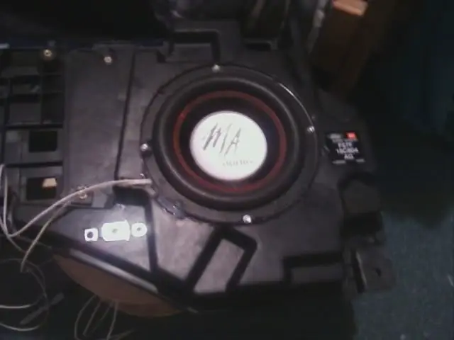

This is what i have. The way my sub fit the box i was able to use silicon to seal the gaps in. I havent installed it into the ex yet, the panel is just sitting in there for a teaser pic. The way my sub(8inch MA audio) is it should fit behind the stock grill with only a little trimming on the lip for the grill. Im not mounting my amp behind the panel like you.
