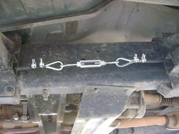

The e-brake is simple. Use the hardware from the 97 axle and cut the 91's cable near the t-case skid. Go to the hardware store and buy some u-bolt clamps, a turnbuckle and some thimbles. Works great. Use a jamb nut so the turnbuckle can not unthread. I used electrical heat shrink to hide the ends of the cut cable.

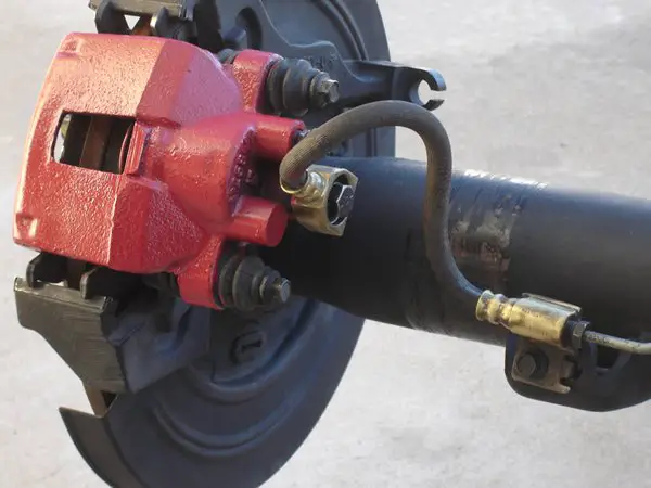

You will need an extra passenger side brakeline to fit the driver side. It will need to be modified by cutting the bracket/tab and turning it over so it fits properly. You will also need to make a new hardline to run to the center to match up with your 91 brakeline. But it sounds like you already have this axle swapped in and plumbed? Did you do it this way?
