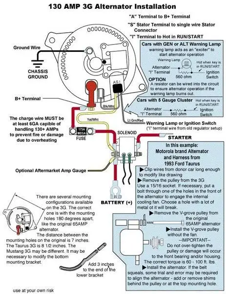

This shows approx. where the fuse should be.

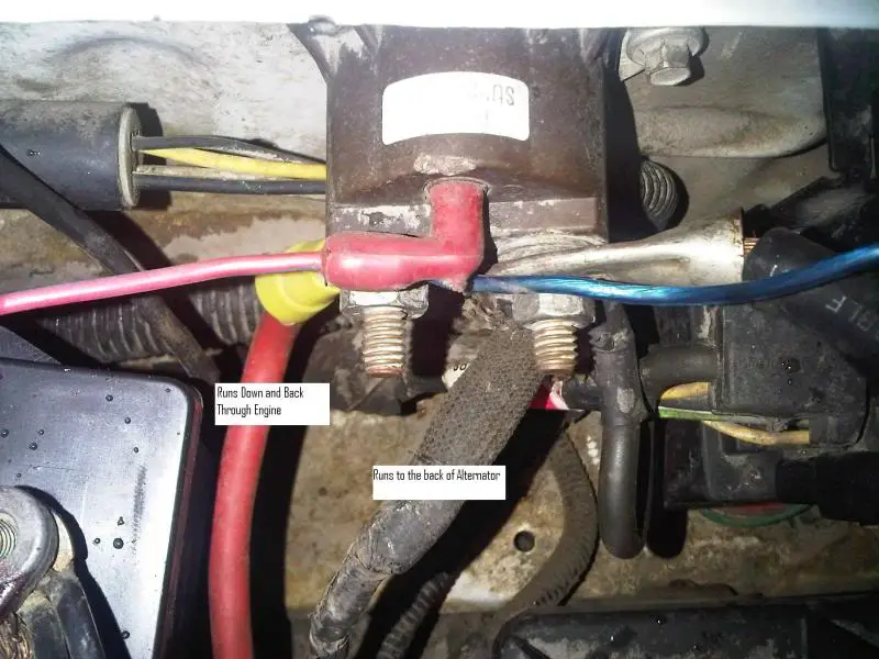

Here's my setup. Fuse box is immediately to the right of the alternator wire where it connects to the solenoid.
None of the wires have a clearly marked or noticeable fuse/box attached to them on my vehicle...
