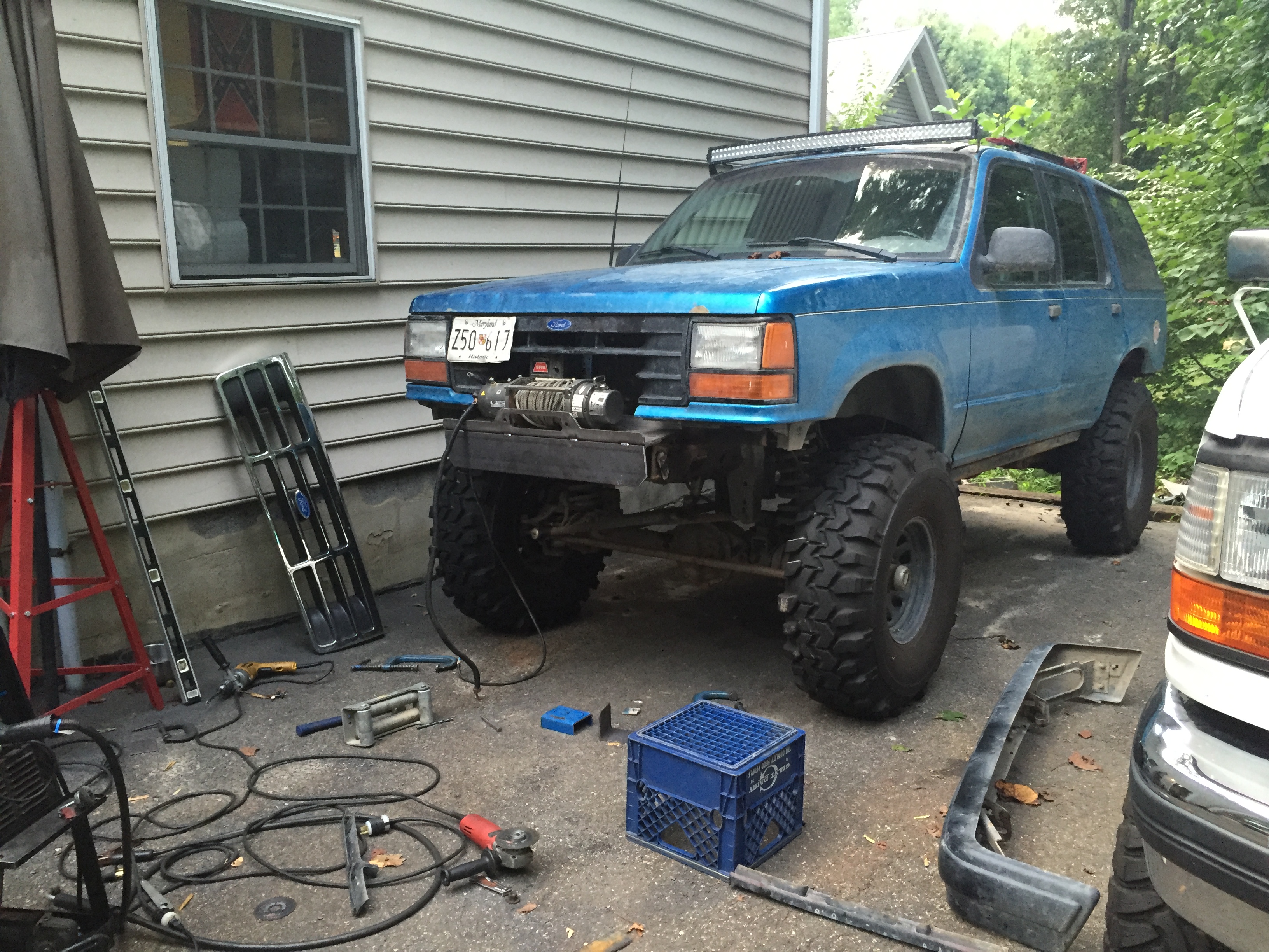

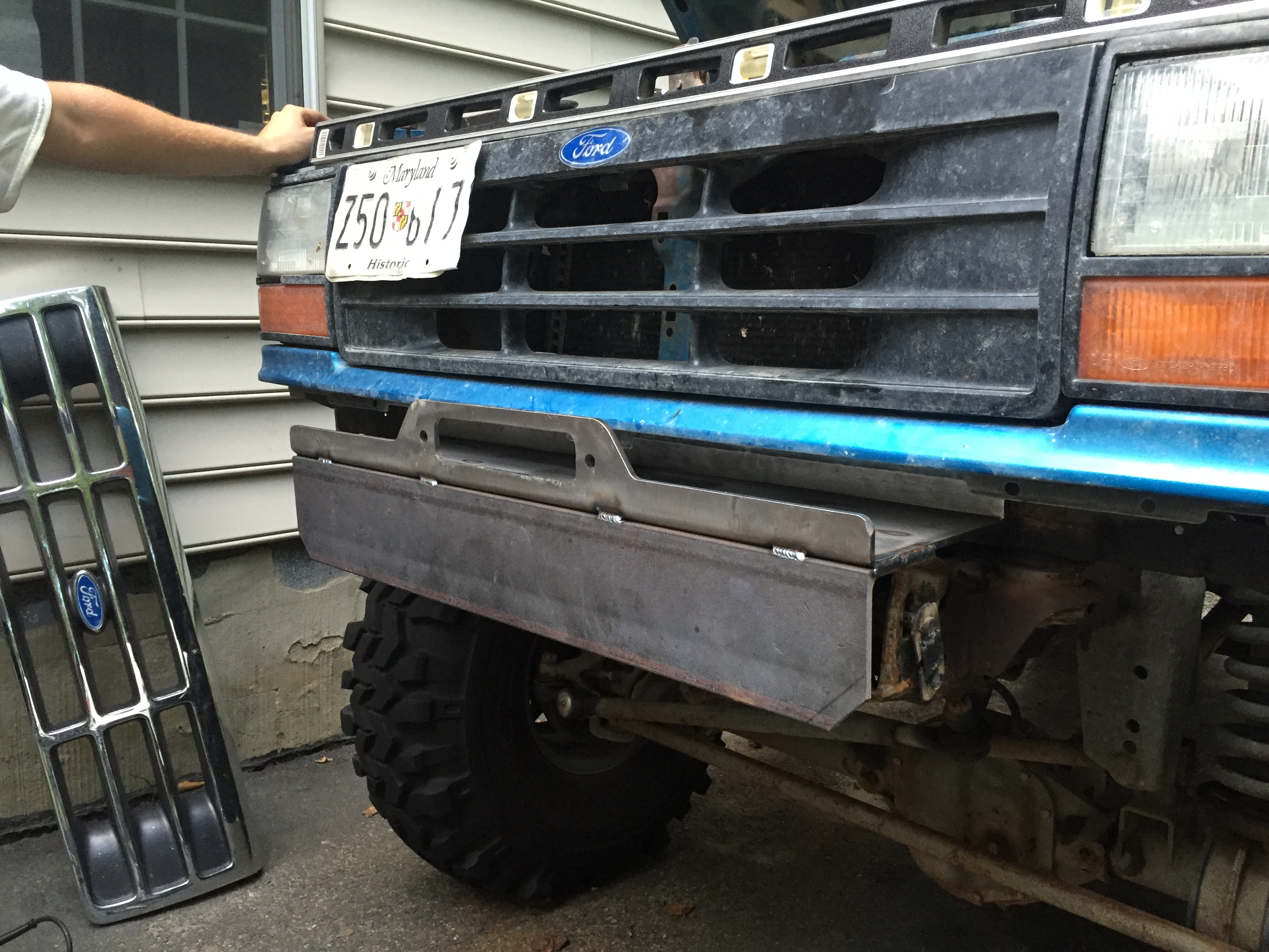

so finally go to do some work on the explorer. started my front winch mount.
plan was to keep it as low profile and close to the radiator core as i could get it. so got a winch plate from bud built and a 3ft piece of .25'' L channel. welded the plate right to the steel and bolted it to the frame.cut the grill out as needed. still need to mount the control pack, and gets some bolts. not sure if i want a receiver hitch up front. but banged it out all within 3 hours....
say goodbye to that Sport grill! raped it
