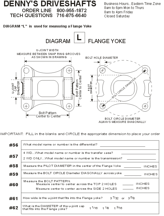

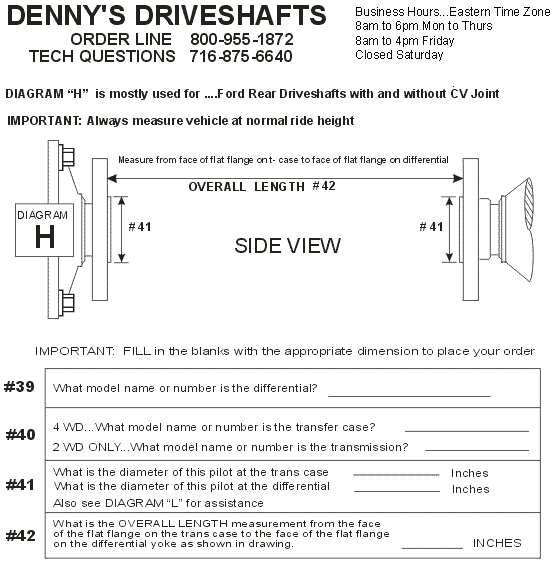

Yes that's normal drive height ..
do you have diagram L?

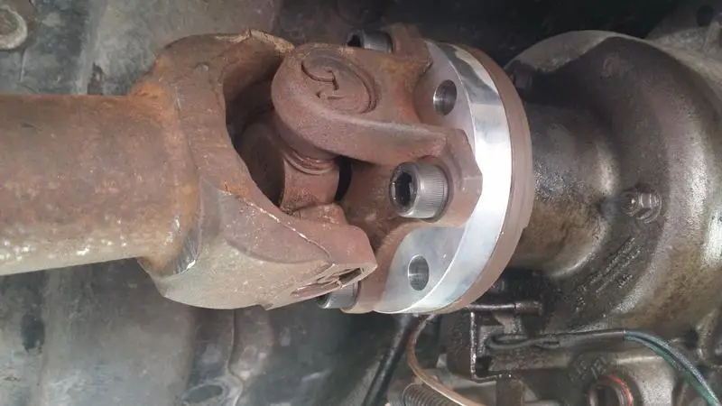

I know 5spdman had problems with a driveshaft spacer.. but i orderd one from ebay and it goes right in.. quick fix till i get my new driveshaft![]()
I see what I did now......tried putting it on the axle, not the t-case. (DUH!!) Guess I know what else I'll be doing to my truck tonight!
