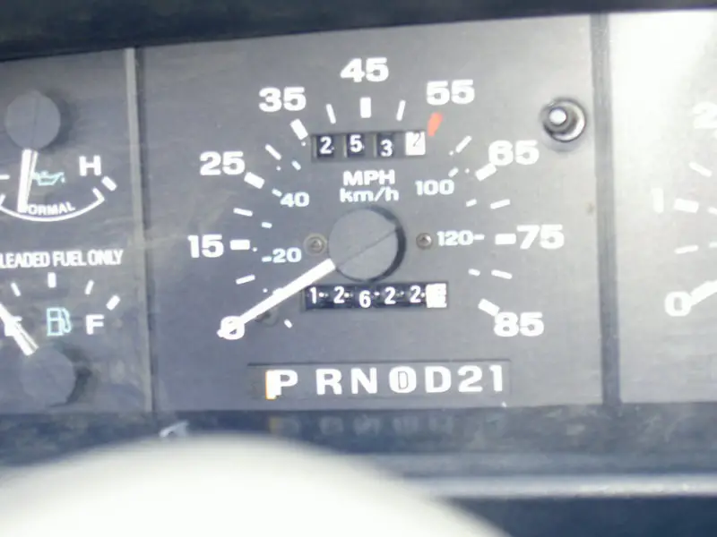

How far are you from east TN? I've still got my original 93 Limited trans, which was 4WD. If you are planning to R&R the trans, you might as well find a place to bench build it. That should cost under $500, long ago that could be a $250 deal from some places I knew. My trans still worked, with 112,622 miles on it when I took the truck apart. But at this age they all need rebuilt.
