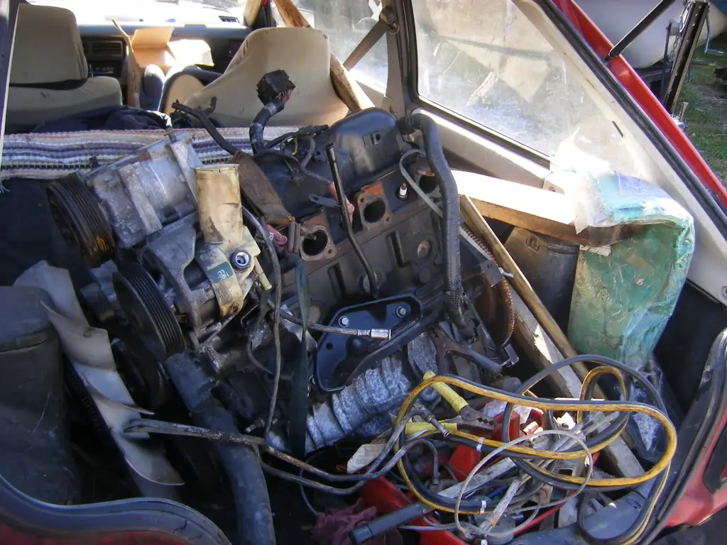

Well I went to the yard and got it!! Fits nicely in the back of my little Toyota Tercel. Pictures will follow...

LOL USS i once pulled a motor from a jy and put it in the back of old Ford Fiesta

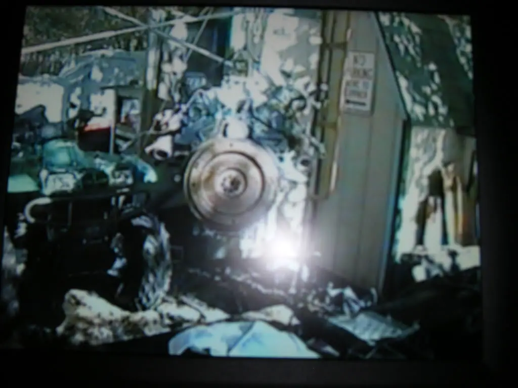

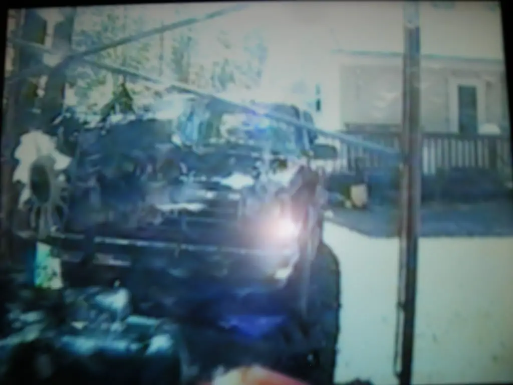

Well I did the swap this weekend. Only trouble is that my neighbor had sold his tractor. We used a scaffold with some boards, a ladder, a pulley with a hook from my come-a-long, and the winch off of his ATV. We then had to move the truck in and out from under the engine. Like I said...Where there's a will there's a way. I have been slowly putting things together. The engine is bolted to the trans and the hood is back on. Hope to have it running by the end of the week.
Red Green would be proud!!
May all your wishes come true. I took videos and took a couple of pics. Not too clear, but you can make it out.
