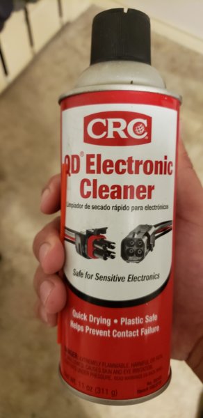

Thanks! I noticed the diodes had some sort of green coating on them. It wasnt noticed up top, but i took apart the fuse box and used a toothbrush to clean since it was more at the bottom. I used a whole can of this guy and air dried everything since it tended to create moisture.
Other than that, its working really good. Thank you for the help!
