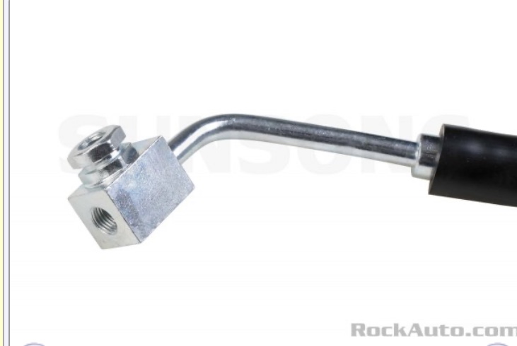

I traced the metal line from the drivers wheel an found it went uninterrupted to the passenger side. I expected to find a ”T” connector on that line that went to the MC but didn’t. There should be two metal lines and hoses going to the drivers Caliper?
This is the brake line side of the front driver side hose. One port goes the the master cylinder. The other port goes to the passenger side front hose.
Badically the front driver hose is your “T connector”
There should be two metal lines and one hose for driver front caliper.
Thanks. It helped a lot to see the part I was looking for. I knew there had to be ”T” connection somewhere on that line. The line was cut flush with the nut and inside the frame. Could not be seen and since it was rounded off it did not feel like a brake nut.
Removed it with small pipe wrench, replaced the line to the master. Both front calipers had broken bleeders. So I ended up replacing both front calipers. Then had to bench bleed the master. Took about 9 hours all told and through some discounts Only about $40 in parts. Now have good brakes at all 4 corners and with that this thread is SOLVED!
