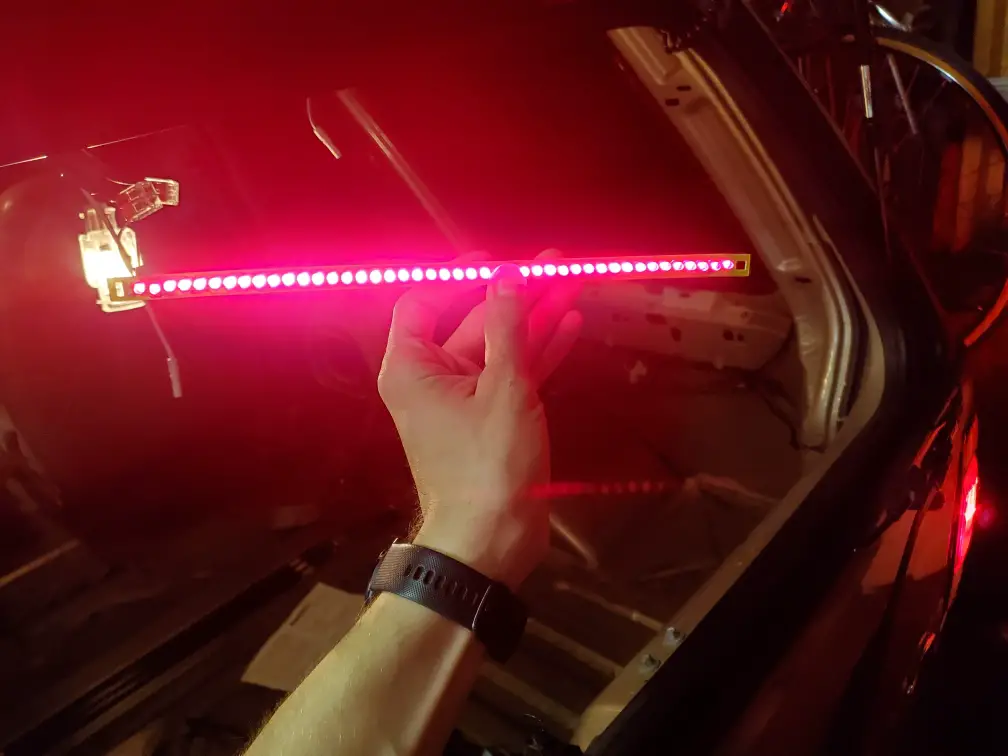

Had a bittersweet goodbye with my '97 today, but I picked up some goodies at the salvage yard including the LED strip from an Oldsmobile Silhouette!
Tried to grab a CHMSL lens from a '97 Mounty, but one of the three bolts was rusted and ripped out of the back of the lamp so I passed on it. I'll see if I can find another, but I may just use the one I already have since I know I'll never be going back to neon. Sounds like a good task to add to my wintertime projects list!
