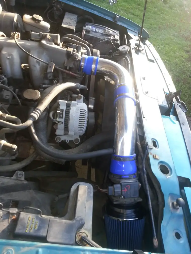

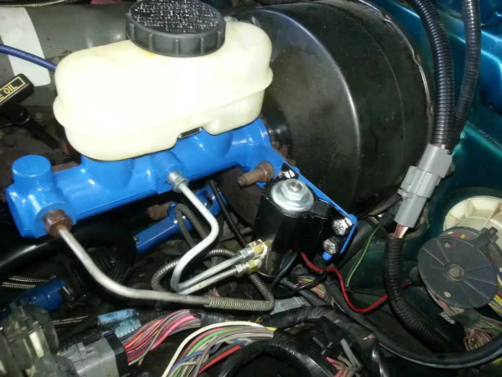

Explorers don't look like the pic you posted and I didn't remember my ranger looking like that but it did.I just looked back at my old pics.I don't know why its slanted like that at all it doesn't sit level in the truck, go look at yours.you can't fill it up completely without it overflowing. I can tell you a 95 sits perfect on a 93 though. .also don't think a .05 makes much difference and if so you could adjust the push rod if you really wanted to
Bad pic but you can see it doesn't sit level. ..94
95 mc on 94
Yeah, you're right. My current m/c in the '93 doesn't sit quite level; although yours appeared to be at a steeper angle (the "old" one). Maybe its just an optical illusion?
Did you keep the older booster, or was that changed too?
What's the solenoid bolted to the booster? A line lock/roll control?
Is the blue on the m/c paint or powder coat? I'm putting a new water pump on soon too, and I hate the idea of my fresh shiny aluminum parts corroding immediately. Same would apply to a new m/c.
It also looks like your truck is the same "green" as my Ranger. "Poly Calypso"
Think its just a bad picture its definitely not level. I kept the stock pre 95 booster on both trucks.
Nailed it, its a line lock;)
Its paint, old ford blue with color effects top coat (changes color in light)
Yea its green for now;)
We better get back on topic now, starting to stray..lol
