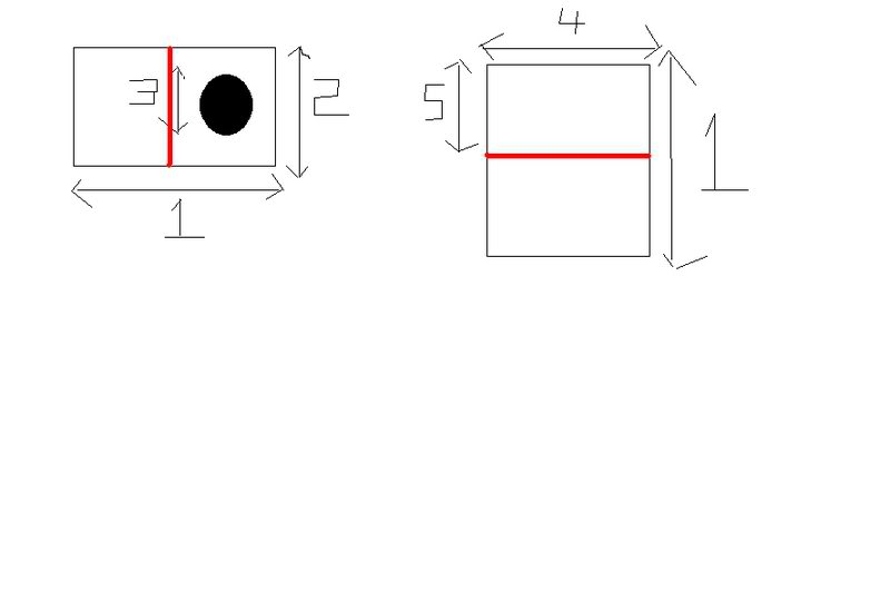

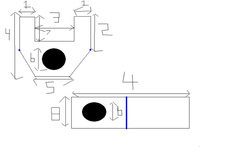

and here are a few paint renderings of the IK and knuckle mounts: (I wish i had a good CAD program, :mad:)
IK mount
IK
where the bushings/bearings would be are where the big black cercles are, i was thinking you could use bushings like this:
you could apply this same concept vertualy any IFS.

They call the "intermidiate knuckle" a hub carrier. I like the setup, but it seems like you would be adding more wear points to your front suspension. if you really want to try it, think about using (and modifing) an outer C from a solid axle (with kingpins). then you will have your hub carrier, knuckles, and brake set-up all in one package. Here's a pic of the same knuckle on a solid axle.

If you're going to go through all the trouble of making "IK"s and "SK"s, why not just fabricate an entire new set of A-arms that bolt right in to the stock holes on the chassis (with all new fabricated "outers")? Making new "IK"s and "SK"s introduces more parts into the system and makes it more complex. Simplicty is one of the attractive features of the solid axle design.

i need to do a good drawing of this to give you guys a clear idea.

Update, i've changed it again for simplicity and space reasons, i think i've got it to its final stage as v3.0. Uper control arms are going to have to be fabricated, due to the factory(factory replacements) being cast, however the lowers should be easily modified due to the fact of them being mild steel. i'm still thinking about some improvements to the design, mostly the lower pins and how that the part in the control arm that rotates (when you turn wheels left and right) will only be 9/16 in diameter. I've made alot of new discitions after examineing the camburg 6.0 performance Ranger EDGE kit and seeing videos of it in action.
I still need to have the CAD class @ my college make me some pictures.
