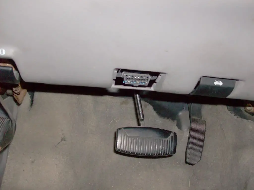

i dont know if yours is in the exact same position as mine but this is the location of the port as well as the shape of the connector so you know what obd-II looks like. this is on my 96 x. if this is the type you have almost all the readers at your local store should work.
Yes, that is what it looks like and AZ was able to read it. Code 0402, EGR problem. The guy at AZ says it is more likely the DPFE sensor. Any thoughts?
