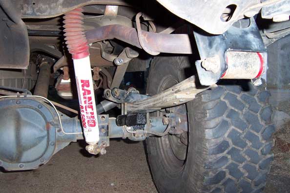

up front i have 3 inch spindles and 2.5" from torsion bars. I have the stock bolts cranked 95% up. in the rear i currently have 6.5" in the rear from a soa with add a leaf. I am sitting about an inch to high so i am planning on takin out the add a leaf and putting the over leaf back in to give me 5.5 inches. I also have a 3" body lift. I will get some more pics of the ouside tommorrow in the light. I am workin on a bunch of thing all at once as you can see.

Have you taken a good look at the rear driveshaft? I just had a SOA done on my 95 and when sitting still, the driveshaft is just about fully extended.
Just letting you know.
Robb
Are 2WD and 4WD 4dr drive shafts the same length?
is your drive shaft extended more than mine? I though mine was extented out far...
Looks good Jeff. The link to become elite is up at the top of this page, right under the box you would click on to see the photo gallery.
That picture you took of your driveshaft, is that they way it always looks now? I'm not sure it's suppose to be "coming out" like that. I thought it met up flush with the back of the tranny.
Happy trails!!
yeah that is how it always is. i think maybe due to the drive shaft angle. I am going to redo the spring over without the aal and see how it looks then.

looks good... next upgrade should be a full locker if you dont already have one..... but reconnect that shock before you drive that thing anymore
