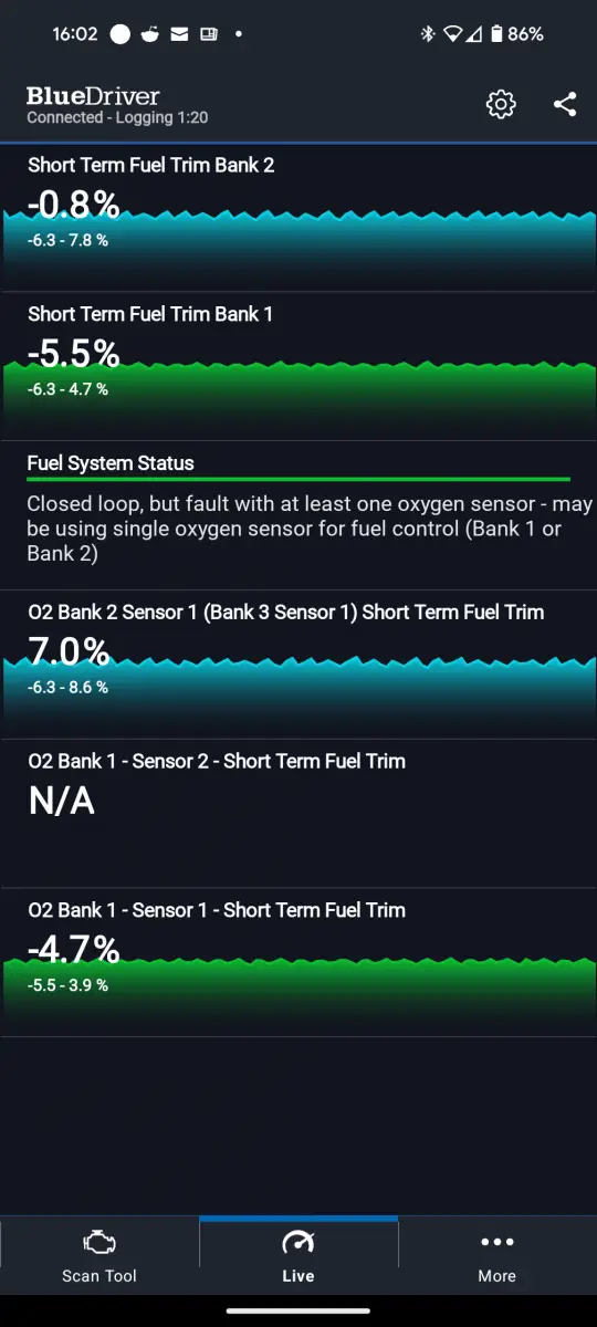

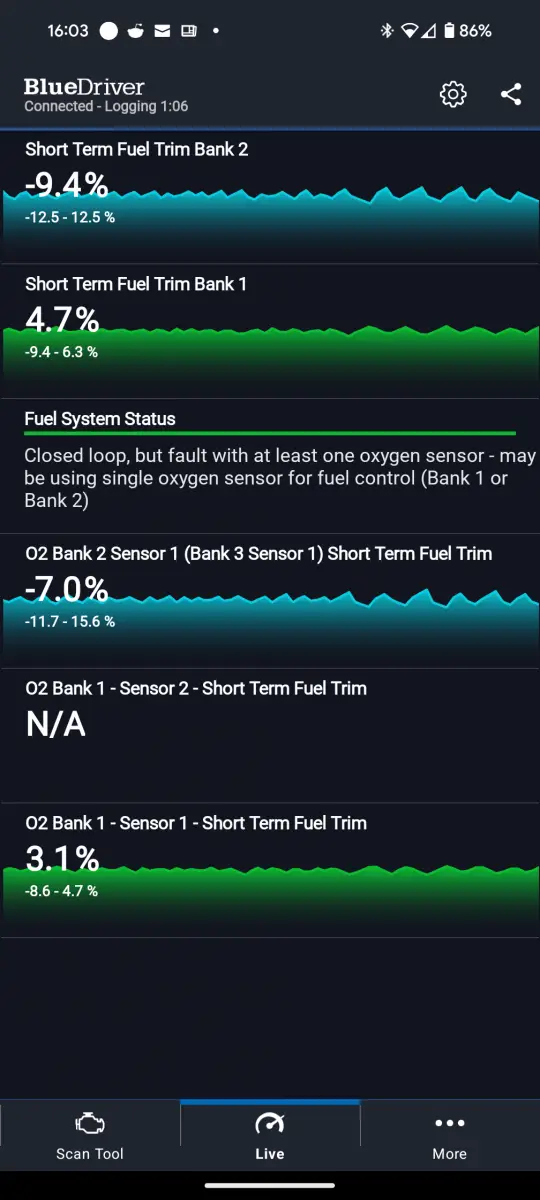

Short term ranges:
Idle (left) 1500 RPM (right)
Long term fuel trim for both banks was steady at 15.6% at idle and 7.0% at 1500 RPM.
