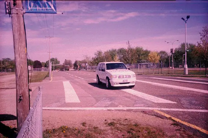

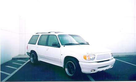

Just got done changing out the front end on my X, replaced the running boards with 98 model rocker trim, lowered it and put new 18's on it. I will start on the back soon, click to see picture of B&A.

Whoa... that looks pretty good! How much time did it take for the conversion?

Looks awsome!! What kind of wheels are those?

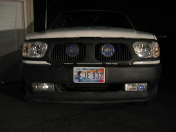

Is that the same type of thing expo 5.0 did? Or did u just do the bumper swap? How much did it run you in parts?

I bought the grille, headlights, mounting panel and bumper assy. for $175.00 exchange for my X stuff. It is pretty much a bolt right on deal, the only drilling required is the hood latch piece that goes on the hood. I had a friend of mine paint everything with some primer then shot it white. I just liked the way the mountainer headlights compared to the X's. I did buy it all used, even found a broken grille to get the center bars to replace the mercury emblem. The wheels are wheelreplicas.com bullitt 18x9 in the front with 255/55/18 Toyo proxses S/T's. The rears are 18x10 with 275/55/18 Toyo Proxses S/T's. expo 5.0 I like what you have done to the grille, looks bmw'ish.

Did it myself, not very hard. Unbolted the one in the salvage yard and mine, then bolted it on mine. Just make sure and get any thing and everything you think you might need.
hey did u take the black rims off? i like the jdm look.
The wheels are 18 inch Bullitts's with black centers. The only problem is I can not get the front center cars on over the hub. Spacers will make the wheel stick out from under the wheel well.
